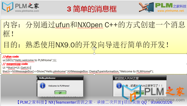

PLM之家-NX9.0二次开发实例视频】3 简单的消息框创建
6 O0 D) t  \+ Y% |" g4 K
内容:分别通过ufun和NXOpen C++的方式创建一个消息框!' E% l) a4 C1 C5 z: @5 [
目的:熟悉使用NX9.0的开发向导进行简单的开发!
  1. /* TODO: Add your application code here */
    , |8 ?) F0 m& s! [. [$ I
  2. uc1601("Hello,PLMHome!",1);
    ; V- C# s, Z9 i
  3. $ r: Z4 a( ^/ {1 {$ U7 v
  4. // get the UI* a5 k/ h' G8 n
  5. UI *plmhomeUI = UI::GetUI();
    9 g4 T3 n1 t+ A/ \! ]$ a1 ]3 ^
  6. plmhomeUI->NXMessageBox()->Show("Welcome,PLMHome",NXMessageBox::DialogTypeQuestion,"Do you want to join?");
    3 ^" ?% U2 F- _# z% e9 f
  7. plmhomeUI->NXMessageBox()->Show("Welcome,PLMHome",NXMessageBox::DialogTypeWarning,"please login!");
    ) U/ D& ~0 j/ o: k
  8. plmhomeUI->NXMessageBox()->Show("Welcome,PLMHome",NXMessageBox::DialogTypeError,"赶紧加入!");
    , q6 l$ ?" |7 Y* L
  9. plmhomeUI->NXMessageBox()->Show("欢迎加入PLM之家",NXMessageBox::DialogTypeInformation," 亲,赶紧加入PLM之家学习了!!");" e! B) x" B" H$ @" L/ B
