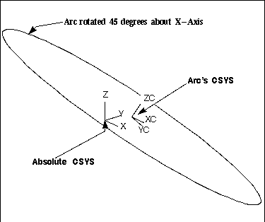

UF_CURVE_ask_arc_data (view source)
Defined in: uf_curve.h
Overview
Returns the data of an arc. The data is in the structure arc_coords
pointed to by UF_CURVE_arc_p_t and includes the matrix tag, start
and end angles (radian measure), the arc center coordinates, and the
arc radius. Another function that provides arc data is UF_EVAL_ask_arc.
Environment
Internal and External
Required License(s)
gateway
int UF_CURVE_ask_arc_data
tag_t arc,
UF_CURVE_arc_p_t arc_coords
| tag_t | arc | Input | Object identifier of arc to query |
| UF_CURVE_arc_p_t | arc_coords | Output | Data of arc in CSYS in which the arc resides. |

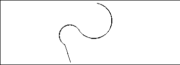

The following example is an internal Open API program that uses the new
offset curve Open API routines. The intention of this Open API program
is to give you and idea of how to set up the inputs and use the outputs from
these routines. Thus, the data used in this example is very simple and is not
representative of the capabilities of this function.
The flow of the code is as follows. First it creates the geometry needed as
input. It creates two arcs and then a ruled surface from the arcs. A string
is set up for the input curves from the arcs and two of the edges of the ruled
surface.
UF_CURVE_ask_offset_direction_2 is called with the string as input to find the offset and draft direction
vectors. UF_VEC3_dot is called to compare the offset direction vector to the
+X axis to see if they are going in the same direction. If not, the distance
string will be negated.
Structures are set up to create a UF_CURVE_OFFSET_DISTANCE_FILLET type offset
curve. These curves will be non-associative. Next,
UF_CURVE_create_offset_object is called to create a UF_CURVE_OFFSET_DISTANCE_TANGENT type associative offset
curve object. Then
UF_CURVE_ask_offset_curves is called to retrieve the output offset curves. These curves will replace the
previous input curves in the input curve string.
UF_CURVE_create_offset_object is called again to create the next set of offset curves.
UF_CURVE_ask_offset_parms is called to read the creation parameters of the object just created. Then the
offset type is changed to UF_CURVE_OFFSET_DISTANCE_NO_TRIM and
UF_CURVE_edit_offset_object is called to update the last object. Finally,
UF_CURVE_free_offset_parms is called to free the memory allocated by
UF_CURVE_ask_offset_parms The following is the output that is generated by the example program.
Input curves are in gray and resultant curves are in green.

UF_CURVE_create_arc (view source)
Overview
Creates an arc. You input the matrix tag, start and end angles in
radians, the coordinates of the arc center, and the radius by filling out
the arc_coords data structure pointed to by UF_CURVE_arc_p_t.
The arc is drawn counterclockwise from the start angle to the end angle
as shown below.
This function returns an error if the absolute value of the difference
between the start and end angle is greater than two pi (plus the system
tolerance). An error is also returned if the start angle is greater than
the end angle.
Environment
See Also
Required License(s)
gateway
int UF_CURVE_create_arc
UF_CURVE_arc_p_t arc_coords,
tag_t * arc

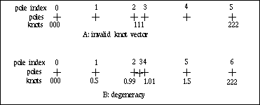

The multiplicity of a knot is the number of times the same value
appears in the sequence. The multiplicity of the end knots cannot
exceed the order of the spline; the multiplicity of interior knots cannot
exceed order-1. The knot sequence must be monotonically
increasing. These problems and degeneracies are fixed using
tolerances assigned by Open API.
Utilities are provided to assist in removing many of these conditions
from your splines using larger tolerances.

Overview
Edit an existing arc. You can edit (change) csys matrix, the start and
end angles, the coordinates of the arc center, and the radius by filling
out the arc_coords data structure pointed to by UF_CURVE_arc_p_t.
angle. The start and end angles are expressed in radians. This function
returns an error if the absolute value of the difference between the
start and end angle is greater than two pi (plus the system tolerance).
An error is also returned if the start angle is greater than the end
angle.

Overview
This function scans the spline data for degeneracies, points that are or
potentially are non-C0, and knot values too close together.
If any degeneracies are found, it attempts to fix them by moving one
or more control points. If that is not successful, points and knots will
be removed, reducing the degree if necessary.
If any non-C0 or potentially non-C0 control points are found they
are coerced to C0.
If any two adjacent knot values that are distinct are not separated by
enough, they are fixed.
The fixed-up data are returned in the same memory as the supplied data.
If valid spline data cannot be returned, it means that the data cannot
be represented by a linear line of nonzero length; it is too short. The
flags in the states return with "WAS" in the name indicate the status
of the input curve data; the output data, if there is no error, is always
valid. The flag with "IS" in the name indicates the status of the
output curve.
Removing degeneracies and fixing illegal knot vectors may introduce
discontinuities.
Specific errors: spline is completely degenerate.
This Figure shows two possible problems with spline data. (Neither
one is to scale.) In the first case (A), the spline has an illegal knot
multiplicity at value 1. It is not C0: there is a gap between points 2 and
3. It is fixed. If poles 2 and 3 are coincident, the shape of the spline is
not changed. If they are not, the spline is changed, and a state is
returned.
In the second case (B), the spline is fixed by pushing poles 2 and 4
away from 3, if it is possible to do so without causing other problems.
If that would introduce other problems, poles and knots are deleted
until the spline is no longer degenerate.
Environment
See Also
History
This function was originally released in V15.0.
Required License(s)
( solid_modeling or drafting )
int UF_CURVE_fix_spline_data
UF_CURVE_spline_p_t spl,
double toler,
int * num_states,
UF_CURVE_state_p_t * states
| UF_CURVE_spline_p_t | spl | Input / Output | spline data in which to fix degeneracies and knot multiplcities |
| double | toler | Input | tolerance to use for determining degeneracies. zero indicates use NX modelling resolution. |
| int * | num_states | Output | number of returned states |
| UF_CURVE_state_p_t * | states | Output to UF_*free* | Pointer to state array pointer to receive state information. If a NULL pointer value is provided, no states are returned. The caller is responsible for freeing this by calling UF_free. |
