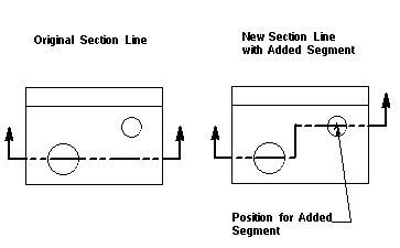

UF_DRAW_add_sxline_sxseg (view source)
Defined in: uf_draw.h
Overview
Adds a segment to a section line, then updates all of its associated
section views located on the current drawing. Associated section views
not on the current drawing are marked out of date. To perform this
edit on the section line without an update, use the suppress view
update feature provided in UF_DRF_set_suppress_view_update.
Figure. Adding a new segment to a section line.
Environment
Internal and External
See Also
Required License(s)
drafting
int UF_DRAW_add_sxline_sxseg
tag_t sxline_tag,
UF_DRAW_sxseg_type_t sxseg_type,
UF_DRAW_sxline_leg_t sxline_leg,
UF_DRF_object_p_t object,
tag_t * sxseg_tag
| tag_t | sxline_tag | Input | Tag of section line |
| UF_DRAW_sxseg_type_t | sxseg_type | Input | Segment_type: UF_DRAW_sxseg_cut = cut segment (only type currently supported for add) |
| UF_DRAW_sxline_leg_t | sxline_leg | Input | If a section line is a two-legged revolved type , UF_DRAW_sxline_leg1= add segment to leg 1 UF_DRAW_sxline_leg2= add segment to leg 2 |
| UF_DRF_object_p_t | object | Input | Object to associate new segment to |
| tag_t * | sxseg_tag | Output | Tag of added section segment |

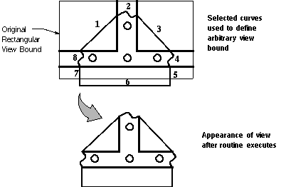

UF_DRAW_ask_boundary_curves (view source)
Overview
Retrieves the view boundary curves, the smart defining points of those
curves, and the tolerance. These items are used to create an arbitrary
clipping bound for a view.
Environment
See Also
Required License(s)
gateway
int UF_DRAW_ask_boundary_curves
tag_t view_tag,
double * tolerance,
int * num_curves,
UF_DRAW_view_boundary_t * * boundary_curves
| tag_t | view_tag | Input | Tag of view whose view boundary curves are to be obtained. |
| double * | tolerance | Output | The chain tolerance used to create the arbitrary clipping bounds for this view. |
| int * | num_curves | Output | Count of structures. = 0 if view does not have an arbitrary boundary defined. |
| UF_DRAW_view_boundary_t * * | boundary_curves | Output to UF_*free* | Pointer to view boundary structure. Use UF_DRAW_free_boundary to free the pointer. If a boundary curve has been deleted, its curve_tag will be NULL. |

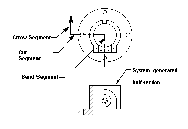

UF_DRAW_ask_half_sxline (view source)
Overview
Retrieves half section line information, given the tag of the section
line. If a section line has an invalid section line status it
does not independently cause the return code to be set to a non-zero
value.
Environment
See Also
Required License(s)
gateway
int UF_DRAW_ask_half_sxline
tag_t sxline_tag,
double step_dir [ 3 ] ,
double arrow_dir [ 3 ] ,
tag_t * pview_tag,
int * num_sxviews,
tag_p_t * sxview_tags,
int * num_sxsegs,
tag_p_t * sxseg_tags,
UF_DRAW_sxline_status_t * sxline_status
| tag_t | sxline_tag | Input | Tag of half section line to query |
| double | step_dir [ 3 ] | Output | Step direction vector (unitized) relative to the drawing: step_dir[0] = x value step_dir[1] = y value step_dir[2] = z value |
| double | arrow_dir [ 3 ] | Output | Arrow direction vector (unitized) relative to the drawing: arrow_dir[0] = x value arrow_dir[1] = y value arrow_dir[2] = z value |
| tag_t * | pview_tag | Output | Parent view tag |
| int * | num_sxviews | Output | Number of section views associated to the input section line |
| tag_p_t * | sxview_tags | Output to UF_*free* | Array of Section line's section views Use UF_free to free memory |
| int * | num_sxsegs | Output | Number of section line segments |
| tag_p_t * | sxseg_tags | Output to UF_*free* | Array of section line segment tags Use UF_free to free memory |
| UF_DRAW_sxline_status_t * | sxline_status | Output | Section line status |

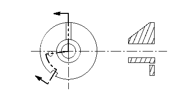

UF_DRAW_ask_revolved_sxline (view source)
Overview
Retrieves revolved section line information, given the tag of the
section line. Note that if a section line has a invalid section line status
it does not independently cause the return code to be set to a
non-zero value.
Environment
See Also
Required License(s)
gateway
int UF_DRAW_ask_revolved_sxline
tag_t sxline_tag,
tag_t * pview_tag,
UF_DRF_object_t * rotpt_object,
int * num_sxviews,
int * num_sxsegs,
int * num_leg1_sxsegs,
UF_DRAW_sxline_leg_t * cut_plane_leg,
| tag_t | sxline_tag | Input | Tag of revolved section line to query |
| UF_DRF_object_t * | rotpt_object | Output | Object associated to rotation point |
| int * | num_sxviews | Output | Number of section views associated to section line |
| tag_p_t * | sxview_tags | Output to UF_*free* | Array of section line's section view tags Use UF_free to free memory |
| int * | num_sxsegs | Output | Number of section line segments. |
| int * | num_leg1_sxsegs | Output | Number of section segments input to define the first leg. Cannot be greater than num_sxsegs. Any remaining segments define leg2. |
| UF_DRAW_sxline_leg_t * | cut_plane_leg | Output | Leg used to define cut plane = UF_DRAW_sxline_leg1 = UF_DRAW_sxline_leg2 |

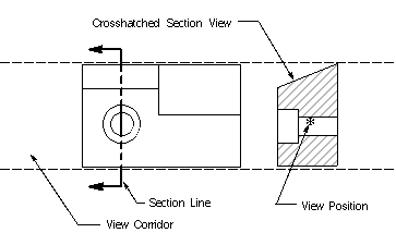

UF_DRAW_ask_simple_sxline (view source)
Overview
Retrieves simple section line information, given the tag of the section
line. If a section line has an invalid section line status, this
value.
Environment
See Also
Required License(s)
gateway
int UF_DRAW_ask_simple_sxline
tag_t sxline_tag,
tag_t * pview_tag,
int * num_sxviews,
int * num_sxsegs,
| tag_t | sxline_tag | Input | Tag of section line to query |
| double | step_dir [ 3 ] | Output | Step direction vector (unitized) relative to the drawing: step_dir[0] = x value step_dir[1]= y value step_dir[2] = z value |
| double | arrow_dir [ 3 ] | Output | Step direction vector (unitized) relative to the drawing: arrow_dir[0] = x value arrow_dir[1]= y value arrow_dir[2] = z value |
| tag_p_t * | sxview_tags | Output to UF_*free* | Array of section line's section views. Use UF_free to free memory. |
| tag_p_t * | sxseg_tags | Output to UF_*free* | Array of section line segment tags. Use UF_free to free memory |

UF_DRAW_create_half_sxview (view source)
Overview
Creates a half section line and view.
Figure. A half section line and section view
Environment
See Also
See the discussion on the half_sxsegs structure in the Types and
See Also
Required License(s)
drafting
int UF_DRAW_create_half_sxview
tag_t dwg_tag,
double sxview_scale,
tag_t pview_tag,
int num_sxsegs,
UF_DRAW_half_sxsegs_p_t half_sxseg_objects,
double view_placement_pt [ 2 ] ,
tag_t* sxview_tag
| tag_t | dwg_tag | Input | Drawing tag |
| double | sxview_scale | Input | Section view scale |
| double | step_dir [ 3 ] | Input | Step direction vector (unitized) relative to the drawing: step_dir[0] = x value step_dir[1] = y value step_dir[2] = z value |
| double | arrow_dir [ 3 ] | Input | Arrow direction vector (unitized) relative to the drawing. arrow_dir[0] = x value arrow_dir[1] = y value arrow_dir[2] = z value |
| tag_t | pview_tag | Input | Parent view tag |
| int | num_sxsegs | Input | Number of section segments. A cut segment and bend segment must be provided (num_segs=2). If the arrow segment location is optionally provided, num_segs=3. |
| UF_DRAW_half_sxsegs_p_t | half_sxseg_objects | Input | Section line segment object structure |
| double | view_placement_pt [ 2 ] | Input | View placement point on drawing in absolute drawing coordinates (x,y)) |
| tag_t* | sxview_tag | Output | Tag of newly created section view |

UF_DRAW_create_revolved_sxview (view source)
Overview
Creates a revolved section view. The system generates a
bend when two cut segments are input with no intervening bend
definition. The system also ignores the second of two consecutive
input bend segments. The system generates arrow segments if they are
not input.
Figure. A revolved section line and section view.
Environment
See Also
Required License(s)
drafting
int UF_DRAW_create_revolved_sxview
tag_t dwg_tag,
tag_t pview_tag,
UF_DRF_object_p_t rotpt_object,
int num_sxsegs,
int num_leg1_sxsegs,
UF_DRAW_sxline_sxsegs_p_t rev_sxsegs,
tag_t * sxview_tag
| double | step_dir [ 3 ] | Input | Step direction vector (unitized) relative to the drawing: step_dir[0] = x value step_dir[1]= y value step_dir[2] = z value |
| UF_DRF_object_p_t | rotpt_object | Input | Object defining rotation point associativity. |
| int | num_sxsegs | Input | Number of section segments used to initially define the section line. A cut segment must be defined (num_segs must be > 0). This number defines the size of the rev_sxseg_objects array. A section line cannot have more than 99 segments and cannot have more than 49 cut segments. |
| int | num_leg1_sxsegs | Input | Number of section segments input to define the first leg. Cannot be greater than num_segs. Any remaining segments define leg2. |
| UF_DRAW_sxline_sxsegs_p_t | rev_sxsegs | Input | For each section segment defined, a segment type is given that determines whether the segment is a cut, bend, or arrow. Bend and arrow segments are optional. Also, for each section segment defined, an object is given to define the section segment associativity. |
| tag_t * | sxview_tag | Output | Tag of newly created section view |
UF_DRAW_create_simple_sxview (view source)
Overview
Creates a simple section line and view. Only the cut segment of the
section line is input. The arrow segments of the section line are
automatically generated.
Figure. A simple section line and section view
Environment
See Also
Required License(s)
drafting
int UF_DRAW_create_simple_sxview
tag_t dwg_tag,
tag_t pview_tag,
UF_DRF_object_p_t cut_object,
tag_t * sxview_tag
| UF_DRF_object_p_t | cut_object | Input | Object associated to cut segment |
| double | view_placement_pt [ 2 ] | Input | View placement point on drawing in absolute drawing coordinates (x,y) |

UF_DRAW_define_view_boundary (view source)
Overview
Creates a view boundary of a closed, connected, non-self-intersecting
loop of curves. Valid curve types are UF_line_type, UF_circle_type,
and UF_spline_type. All curves must be visible in the view. If the
curve type is UF_circle_type, the circle must be in the plane of the
view.
The Figure below shows an example of the the construction of an
arbitrary view bound defined by selecting several curves. In the figure, the
numbers associated with each curve are used to illustrate the curve selection
order.
Figure. Construction of an arbitrary view bound
Environment
See Also
Required License(s)
drafting
int UF_DRAW_define_view_boundary
tag_t view_tag,
int curve_count,
UF_DRAW_define_boundary_p_t* boundary_curves
| tag_t | view_tag | Input | Tag of the view whose boundary is to be defined. |
| int | curve_count | Input | Count of tags of curves in curve_list |
| UF_DRAW_define_boundary_p_t* | boundary_curves | Input | curve_count Pointer to array of structures that are used to define the view boundary. |

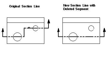

UF_DRAW_delete_sxline_sxseg (view source)
Overview
Deletes a segment of a section line, then updates all of the section
line's associated section views located on the current drawing.
Associated section views not on the current drawing are marked out
of date. To perform this edit on the section line without an update, use
the suppress view update feature provided in UF_DRF_set_suppress_view_update.
Figure. The deletion of a section line cut segment.
Environment
See Also
Required License(s)
drafting
int UF_DRAW_delete_sxline_sxseg
tag_t sxseg_tag
| tag_t | sxseg_tag | Input | Tag of section line segment to delete |

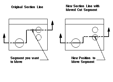

UF_DRAW_move_sxline_sxseg (view source)
Overview
Moves a section line segment to a location defined by the input
new_object, then updates all of the section line's associated section
views located on the current drawing. Associated section views not on
the current drawing are marked out of date. To perform edits on the
section line without an update, use the suppress view update feature
Figure. Moving section line segments
Environment
See Also
Required License(s)
drafting
int UF_DRAW_move_sxline_sxseg
tag_t sxseg_tag,
UF_DRF_object_p_t new_object
| tag_t | sxseg_tag | Input | Tag of section line segment to move. |
| UF_DRF_object_p_t | new_object | Input | New object to associate segment. |
