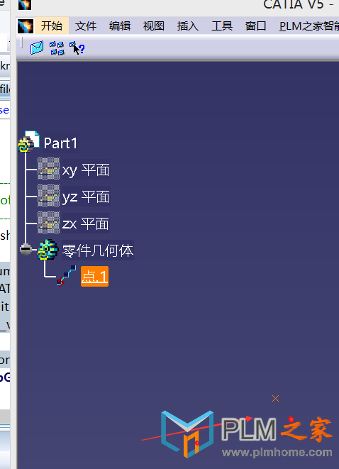

CATIA二次开发入门教程---18 创建一个点8 v1 {% y( C' F! j" l0 m  p9 y

# k. @( x3 `4 [7 p4 W5 ]# J[mw_shl_code=c,true]////////获得Editor、Document、Container、设置GSMFactory- c- v; n$ A8 E. x/ ]% p
        CATFrmEditor* pEditor = CATFrmEditor::GeTCurrentEditor();3 h/ P9 v/ X9 Y
        CATDocument *pDoc = pEditor->GetDocument();
5 I2 i  ^2 r# s% G& g        CATIContainerOfDocument_var spConODocs = pDoc;
9 F) z0 y9 g) D( D- p2 [! F9 {# ^& v3 k! ?4 a: o( T
        CATIContainer*            _pContainer;                //Container7 ]4 h4 M1 ?, N; O% H9 r
        CATIGSMFactory_var        spGSMFactory;                //GSM工厂
& k7 m2 ~9 e& U/ a* ]' r) V
, E' ~( L9 \$ t- s1 W+ a        _pContainer = NULL;
) ^9 t  v& x: H' @5 d( z        HRESULT hr = spConODocs->GetSpecContainer(_pContainer);9 X3 S+ }" A8 S. W: h5 W6 M
        spGSMFactory = NULL_var;2 t/ l' p- g( V
        spGSMFactory = _pContainer;
3 m) r6 j. D0 p3 |& g0 ^        //设置点的坐标
2 Z' r0 e" W7 J; \' |8 I        CATMathPoint _Point;0 k4 h4 P8 M3 |6 E7 s7 {
        _Point.SetCoord(10,10,10 );  w  B* C6 F' F. q) M
        /////////////////////用以上得到的Point3D画点
! h1 A/ ^8 i; n% z        CATIGSMPoint_var spPoint1 = spGSMFactory->CreatePoint(_Point); //创建一个点5 L# r) Z" k9 j3 B# H8 R
        CATISpecObject_var                spSpecPoint1;6 E$ Y# M+ N: n# `; z& i7 {
        spSpecPoint1 = spPoint1;                                //Casts the point as a CATISpecObject, z# v' o  p  _+ D( f- g
        CATIGSMProceduralView_var spSndPntObj = spSpecPoint1;8 q( B. V0 n) n, C3 m' Y
        spSndPntObj->InsertInProceduralView();+ i! j7 x7 A7 W, i6 z
    spSpecPoint1->Update();
5 Z& B) _( V+ W7 I# V, w" |2 r% x        // Add your code here[/mw_shl_code]' J. B; e$ w1 L
