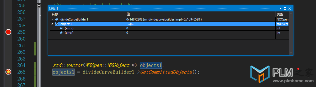

 楼主| 发表于 2020-4-5 10:47:20 | 显示全部楼层
C:\Users\99112\Desktop$ T$ _: `% j( b* H, A4 T+ ^
捕获.PNG 9 m3 L* f/ a7 `: k( u
[mw_shl_code=cpp,true]objects1 = divideCurveBuilder1->GetCommittedObjects() [/mw_shl_code]的值一直是两个0,这段是录制jounal生成的,源代码就是这么获取的/ b0 a* c$ z# R$ f5 Y4 i
- h# \9 l1 J5 v+ j
我用
) c0 N& x8 a- Z2 o/ a5 z$ q, p* y% U
5 Q. u* ^* h* a4 B8 @0 o# L
8 `) _  j1 u  a) E  Z) `[mw_shl_code=cpp,true]        Features::Feature *feat1;# V* K5 f5 h' t) I1 E' y/ ], d
        feat1 = divideCurveBuilder1->CommitFeature();[/mw_shl_code]
8 l( e5 I% h& ?+ O, B代替# Q' F1 @0 J2 ]0 l
[mw_shl_code=cpp,true]    NXObject *nXObject1;# L- v) r: l8 K  Z- e# I6 _, |6 n
    nXObject1 = cylinderBuilder1->Commit();[/mw_shl_code]
1 g( P" y1 W, V  F3 q2 P4 b也可以分割一条曲线成两条   但是我想用这两条线怎么获取他们的tag??
4 I4 b* [7 W  e. g" s; L希望指点一下?
