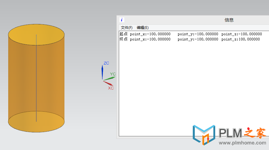

发表于 2016-3-20 17:20:42 | 显示全部楼层 |阅读模式
代码:
, P+ Z+ U% p4 H: ?0 p+ G# V% h5 c; O
        //创建new part8 \2 E0 T5 w6 D6 m2 ~. E6 X/ b
        tag_t part;$ ]! k, f4 R8 S
        UF_PART_new("D:\\newpart_001.part",1,&part);
2 u4 M% y! q: J8 J& F( _: M
3 `  v5 |8 e" }5 z1 h$ c        //创建圆柱
( Y+ o$ c7 A0 J2 w        double origin [ 3 ];0 F. x+ [/ Z, `' E/ f! I8 J3 I
        origin[0]=-100.0;# L0 e. q' l2 N/ S
        origin[1]=-100.0;
7 ?# n/ _5 o6 ?7 X3 U9 J: Q        origin[2]=-100.0;
% L" ~! ]% s- g. q4 [: |        char *height="200";
% g8 p/ @7 v/ b        char *diam="120";
4 l4 q) I  q2 i5 f( N        double direction [ 3 ];
8 u; e+ p0 l5 P8 u        direction[0]=0;" d+ v! }6 C9 P; W! v0 Q
        direction[1]=0;+ Q% r- z* [- d3 `
        direction[2]=1;4 K, Z2 C5 l' }% }
        tag_t cyl;
2 ~6 v& o+ N" \. F        UF_MODL_create_cyl1(UF_NULLSIGN,origin,height,diam,direction,&cyl);
* _2 u# c1 Z* I/ s$ T) L6 k) {1 Z; @) z' q* ~0 f$ L4 F
        //创建中心线
) L: y* p1 h1 S" t+ A+ x        UF_CURVE_line_t line_coords;
" F) l! L$ h: w5 A& ?, p" V9 H        line_coords.start_point[0]=origin[0];
/ k6 @/ G( v- c" t* s        line_coords.start_point[1]=origin[1];
( Y2 }$ I/ D. I6 s, \  c        line_coords.start_point[2]=origin[2];9 ]5 C1 l0 D2 g  ~5 l
2 R- s: w: f+ s' |) Y
        line_coords.end_point[0]=origin[0];4 f5 y4 p0 }5 C! ?) V6 E
        line_coords.end_point[1]=origin[1];
3 e& R4 b- m! M8 H0 t' L6 H        line_coords.end_point[2]=origin[2]+200.0;
% m. U. W5 F" K& a' Q, M  q6 y* z1 c# [; x6 k
        tag_t line;
' f8 U& ^/ m' F: `
! q7 I8 P5 A& X7 H        UF_CURVE_create_line(&line_coords,&line);2 d# L& Q3 @" j) y8 t) @  i- [
1 \) L) J7 T+ }
        //获取曲线参数& O; a1 {* g% u0 k6 o  |
        UF_CURVE_line_t the_line_coords;5 }8 C* q9 {; |1 Y" G
        UF_CURVE_ask_line_data(line,&the_line_coords);: c% J. j* h- K2 R1 z- K  W
, N: l* c6 o0 V: n        char msg[256];/ e6 |2 e0 Y7 q- d* l4 r' O
        sprintf(msg,"起点 point_x:%f\tpoint_y:%f\tpoint_z:%f\n终点 point_x:%f\tpoint_y:%f\tpoint_z:%f\n",
. w0 \7 W" }- p, q; s4 u                the_line_coords.start_point[0],the_line_coords.start_point[1],the_line_coords.start_point[2],
; N4 [2 S2 t9 T2 G8 [% b: O6 V                the_line_coords.end_point[0],the_line_coords.end_point[1],the_line_coords.end_point[2]);# u% R8 i, W. @5 I) P% c
% W% A9 _$ S8 N) X! S$ E
        UF_UI_open_listing_window();4 g+ a3 ^# }& F3 q" D! V  p7 _8 U# L
        UF_UI_write_listing_window(msg);  b9 N4 X5 B% A! [* u1 B" I
2 e  F; |+ g/ x7 h. d. n
        UF_PART_save();/ ]; s2 C& R: w7 q. B/ t! I
        UF_PART_close(part,1,0);4 j1 r- R+ W. K6 F; z- P
' F/ K( r1 ]! ~: b0 @+ A/ C- O
运行效果:/ w3 H5 z# l. U, a7 o  A! A: y
7 g2 @- M3 w9 q6 O7 f9 j0 ]( W1 t- ^9 {8 [! L* J0 Z
发表于 2016-3-20 18:26:34 | 显示全部楼层
不错 如果你更改下 圆柱的方向,你的还能正确显示吗?
