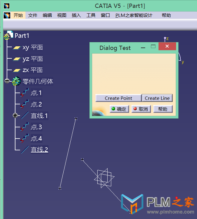

/ J& F- W2 R% w% h! H5 f; ?和上面例子类似,这里需要手动添加一些action事件,在头文件里面新增加一个 indication,效果如下
# h8 b6 O% R. j  d& C8 G6 O create line.PNG - h; {+ s# z1 Y) h
& S" t/ ^/ f. s3 Q, Q5 }; e代码如下:
. n* t5 G3 ^3 e9 |/ w* w" m( b( b5 {( O

) t4 N$ R' e/ t0 z! q  CATISpecObject_var spSpecPoint2= spPoint;
8 }: D) ~5 o4 {* ?2 @  CATIGSMProceduralView_var spSndPntObj = spSpecPoint2;. [3 D# x9 N/ q6 ~
  //*将点显示在屏幕上" U& B. t7 k. U4 i
  spSndPntObj->InsertInProceduralView();
# }  o9 A( {0 j' c  spSpecPoint2->Update();) K3 x) F* v/ s0 K
  //生成线
# m5 C) M* X& }+ x& o& c% M  CATIGSMLinePtPt_var spLine = spGSMFactory->CreateLine(spSpecPoint1, spSpecPoint2, NULL_var);
- H3 R2 E( N3 T7 \1 b* {  CATISpecObject_var spSpecLine= spLine;     # ^8 X* A8 i3 D
  CATIGSMProceduralView_var spSndPntObjLine = spSpecLine;
' c4 E& j% o( n% T6 V  //*将线显示在屏幕上" [' p+ Z7 u' w- \
  spSndPntObjLine->InsertInProceduralView();' E+ W: `0 F( L. b" l
  spSpecLine->Update();
0 z/ b7 Z! L4 a  i4 V& W( D
$ Z8 |/ d+ j" j: F  c0 y return TRUE;
3 m0 K+ V: l5 C( G0 i/ ^' j2 \# P}
