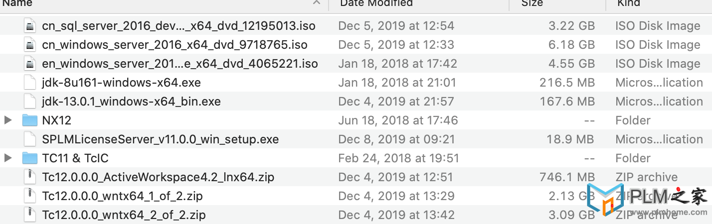

(1) 下载后的安装包文件如下:
7 _5 c0 m  b+ y( n# c# j2 ]! F% \; E* a* z
Screen Shot 2019-12-14 at 15.27.09.png 8 \8 z( b% z5 [6 e9 P
这里主要是TC的安装包,Java去下载最新的,1.8.20以后的都可以支持,另外就是license server下载最新的

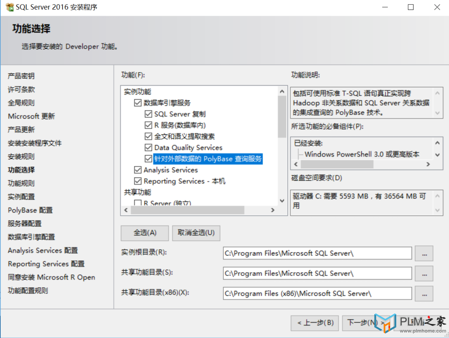

    After setup support files are installed, the wizard displays the Install Rules pane. Click Next.
  • In the Feature Selection pane, select Instance FeaturesDatabase Engine Services and any other features you want to include.
    Click Next.

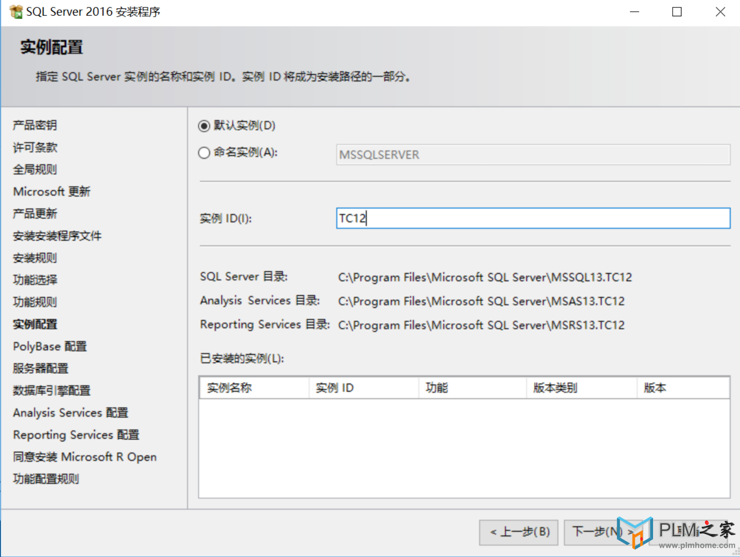

  • In the Instance Configuration pane, select an instance type. Teamcenter supports both Default Instance and Named Instance.[url=]NOTE[/url]
    Note
    A default instance in a Microsoft SQL Server installation uses the name MSSQLSERVER. Teamcenter's persistent object manager (POM) utilities cannot connect to an instance with this name. If you use a default instance, make sure you connect to the instance using a port connection rather than the name.
    If you use a named instance, make sure the instance has a unique name other than MSSQLSERVER.
  • Enter remaining instance configuration values, and then click Next,

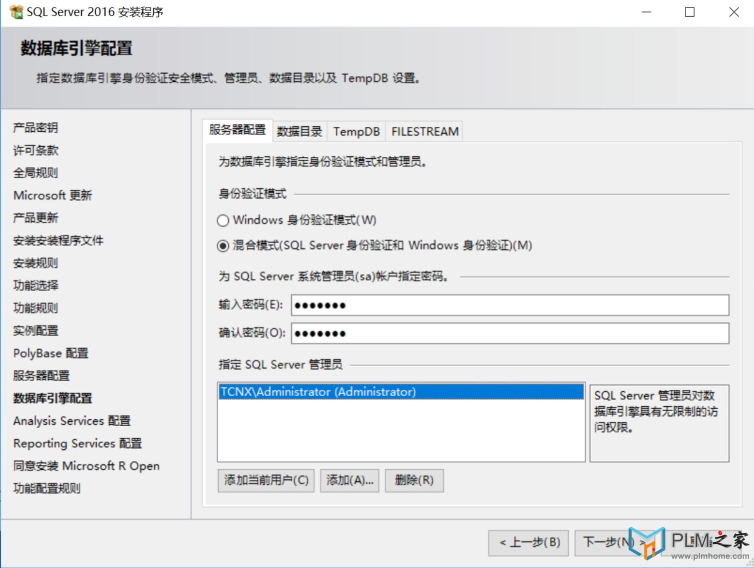

  • Proceed to the Database Engine Configuration pane.
    5 A4 H9 x# W. P- X& j1 [- L9 r% A6 c
    • Click the Server Configuration tab.
    • Under Authentication Mode, select Mixed Mode and define a password for the SQL Server sa logon account.
    • Specify at least one SQL Server administrator account.
    • Click Next.

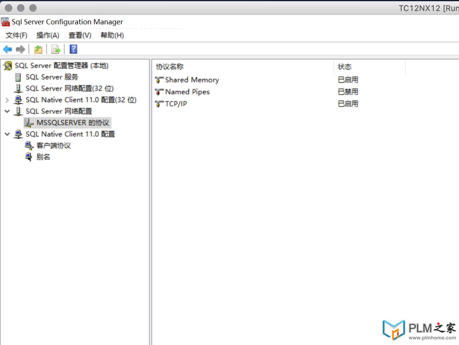

Teamcenter requires TCP/IP protocol to be enabled, but this protocol is disabled by default when you install Microsoft SQL Server. Before you install Teamcenter, make sure you enable TCP/IP protocol.
For more information about enabling TCP/IP protocol in Microsoft SQL Server, see the Microsoft online help resources on the Internet.

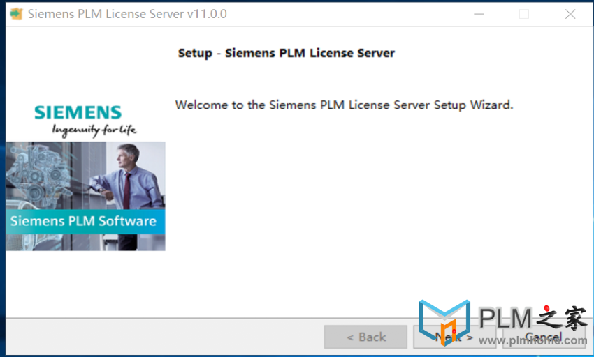

6 D7 h+ o4 a" q' N(3)License 安装
1 {+ {/ E1 S7 L( S配置好license,一步步安装完成即可,license会自动启动,注意计算机名不要有特殊的符号

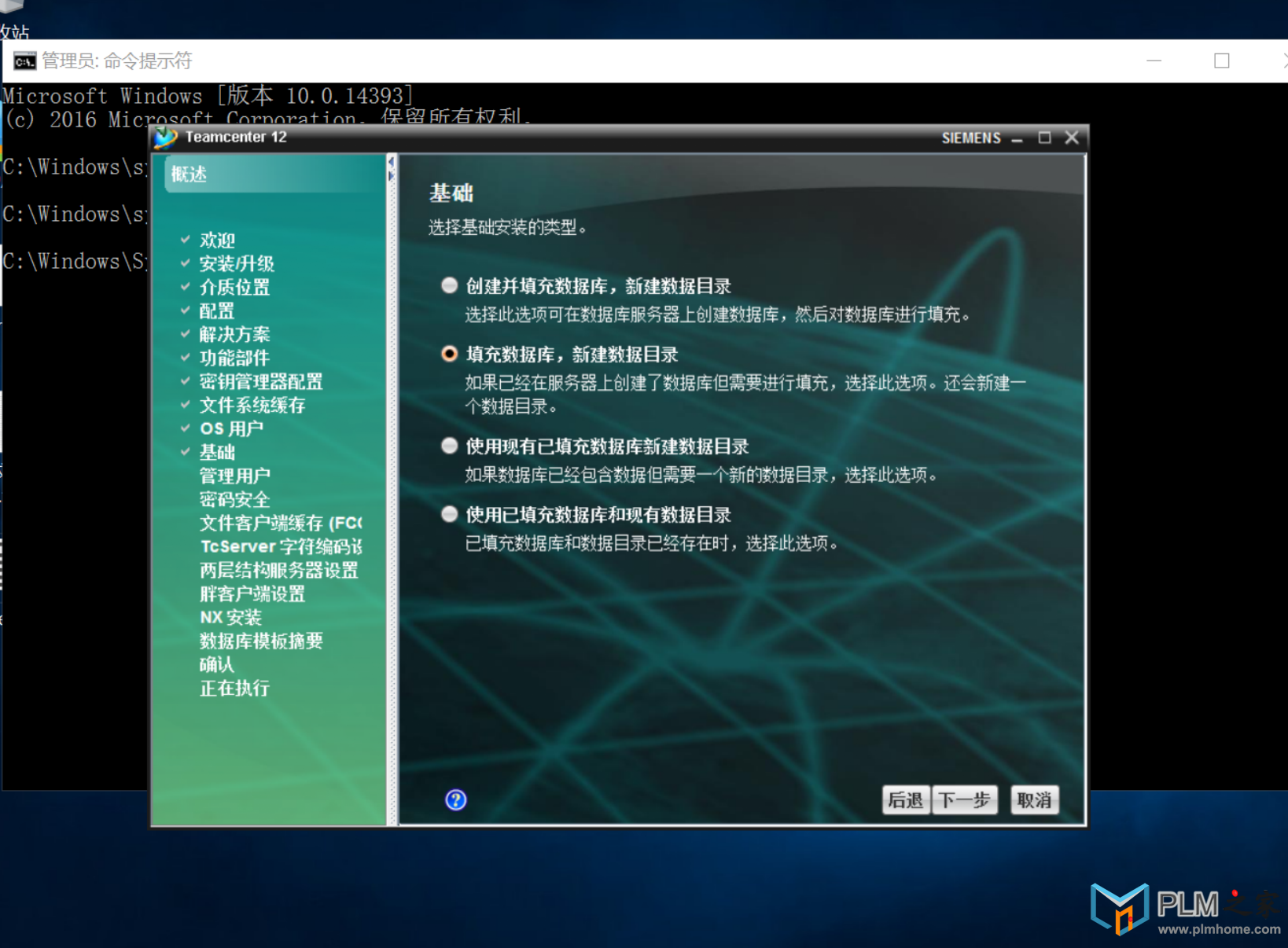

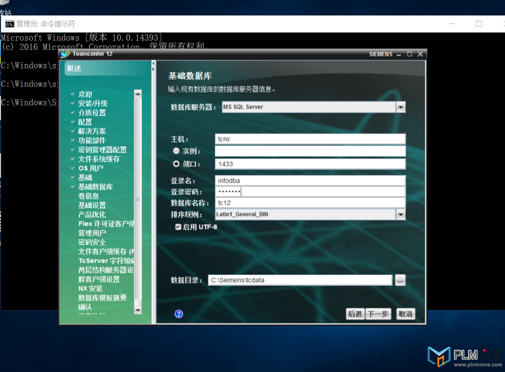

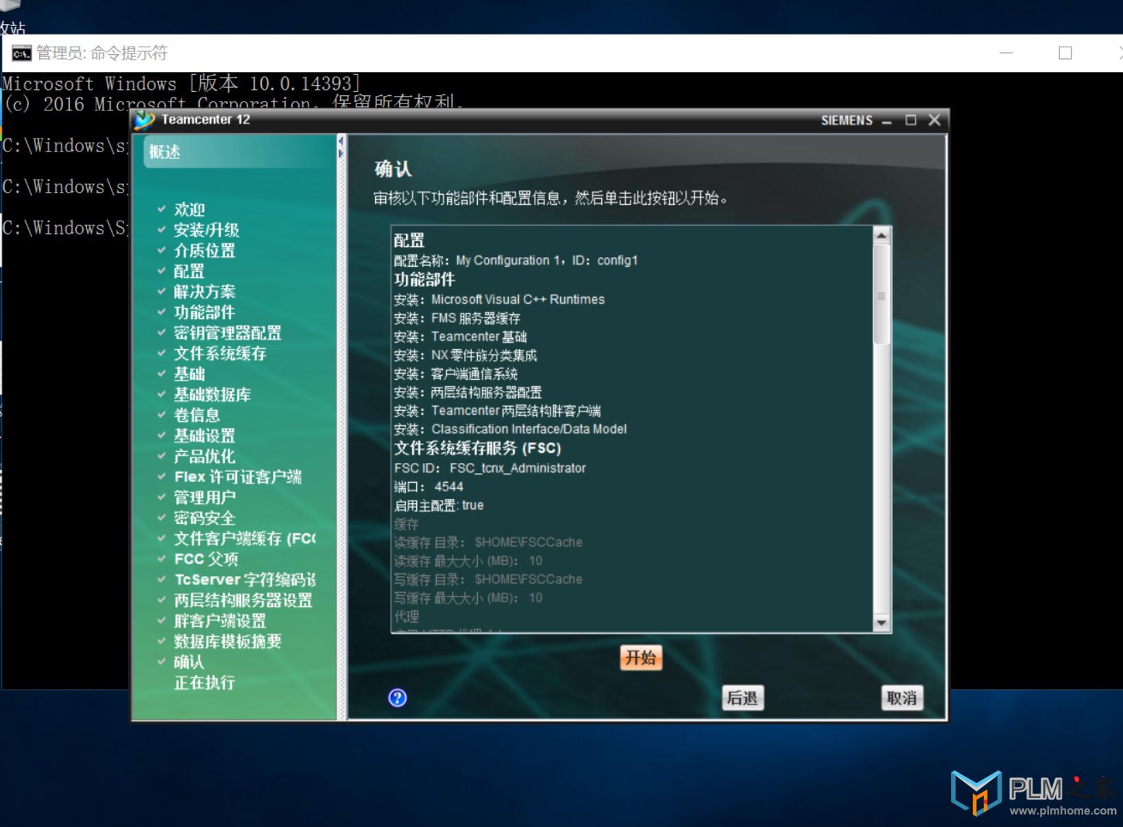

. X% ~. H0 f4 x4 U1 M4 P3 P+ @$ Y(5)Teamcenter 两层安装, g9 @' o. l% f) ?0 i
到了软件安装过程了,确保连个压缩包都解压,集中放在第一个里面。, R) u. T* _7 i* ~; o+ T  |
注意jre64_home的环境变量设置正确,我个人通常就是启动cmd命令,直接set下即可,确保tem.bat 界面启动,简单起见,我们这里将 corporate server,volume server,相关服务装在这一台机器上,一次性安装完毕两层。
* d2 _" \9 P$ }* S

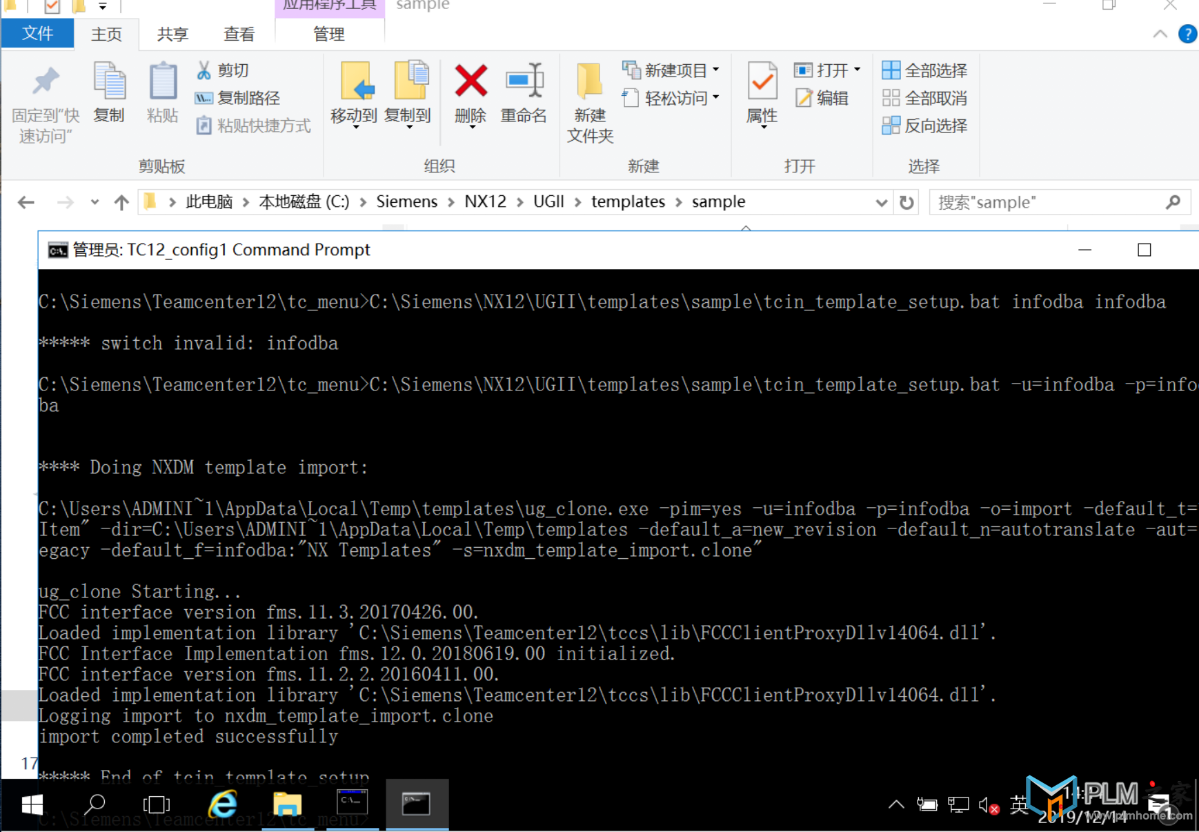

& Q" l/ B8 [; t. `(6)NX集成安装) S$ u3 T) i  P" R$ K; [: `
安装后,需要安装和TC的集成模版,启动TC命令行,访问NX安装目录下的UGII/templates/sample/安装 模版/ K" |$ A* v4 P$ D. b. L, Q
/ j/ o- J8 P) S7 _# k: ~( }3 ]
Screen Shot 2019-12-14 at 14.49.17.png 9 |2 m5 w, [& ~' N& Z
; I% @1 P+ T1 A
需要再次启动安装好的TC tem环境,勾选NX集成相关的选项,安装完成即可

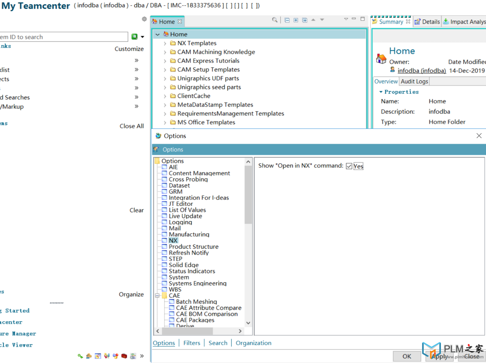

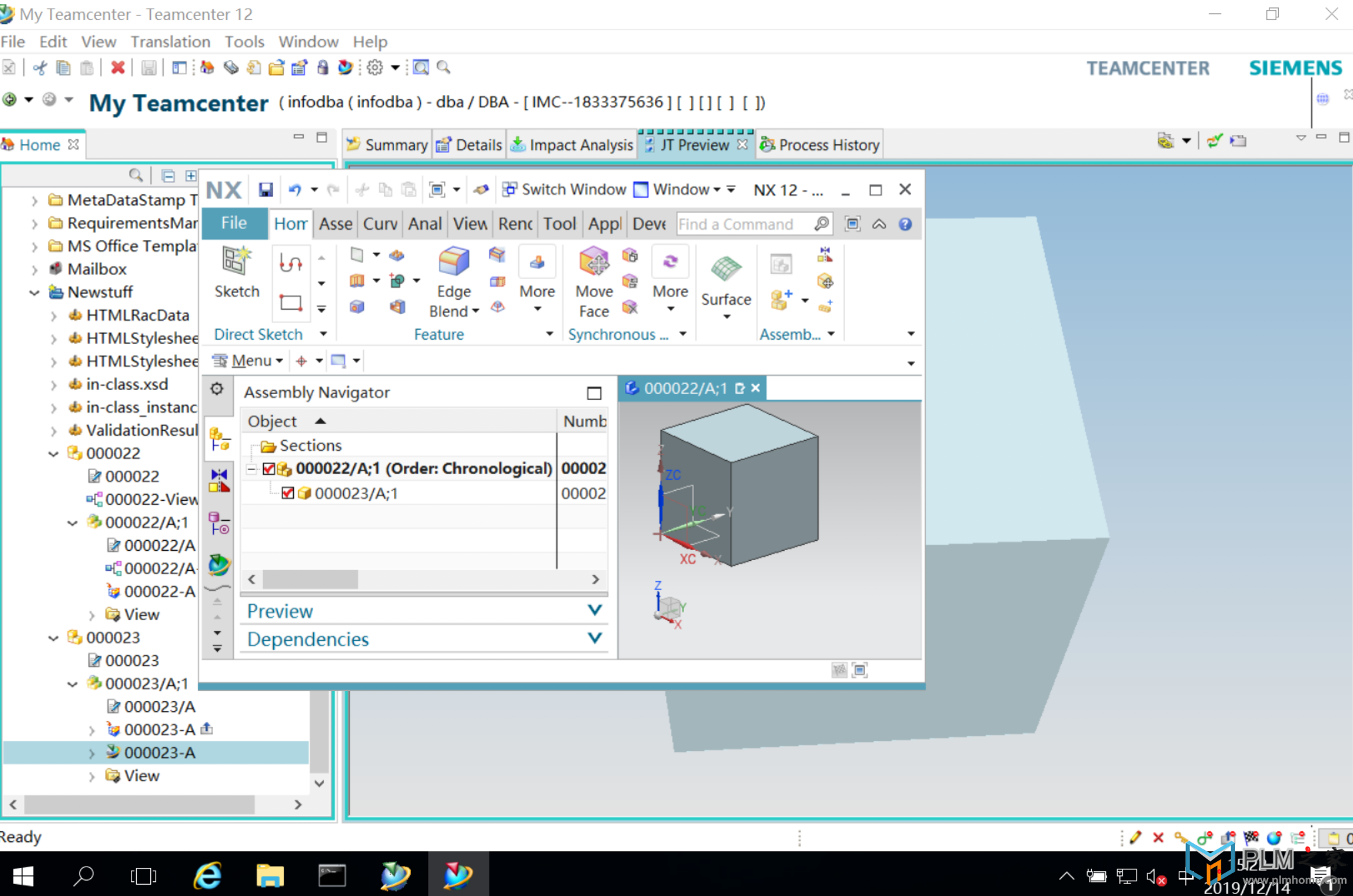

(7)测试,验证,启动ok ,NX 保存ok
