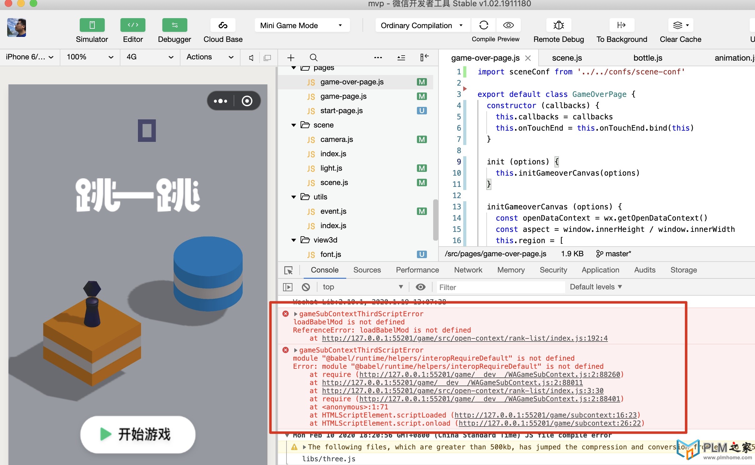

发表于 2020-2-10 18:25:47 | 显示全部楼层 |阅读模式
- F' d! `# Y8 d微信小游戏开发,报错如下
% _- G$ j7 a  ]# q1 O
8 [# s- Z9 M& C4 ? Xnip2020-02-10_18-21-27.jpg ; |- o/ y9 ?- D4 [/ Z
$ w7 z* W0 V( b1 P" }
Wechat Lib:2.10.1, 2020.1.19 13:07:38& v+ s7 B+ E7 d4 {: ?, V
VM5465:1 gameSubContextThirdScriptError2 I0 S' X" U- ~, W: ?$ W5 z
loadBabelMod is not defined
0 r, \" L' o# ~9 c2 K; a+ {2 RReferenceError: loadBabelMod is not defined% y$ D7 _, \, Q: w
    at http://127.0.0.1:55201/game/src/ ... list/index.js:192:4
; R* G) H+ {/ M+ |* ?4 Rconsole.error @ VM5465:1$ A3 L9 Q, H! R6 k8 `
errorReport @ VM5483 WAGame.js:2
: |. X+ \, u6 P: Q$ S) R/ D( _$ N, i; [- u

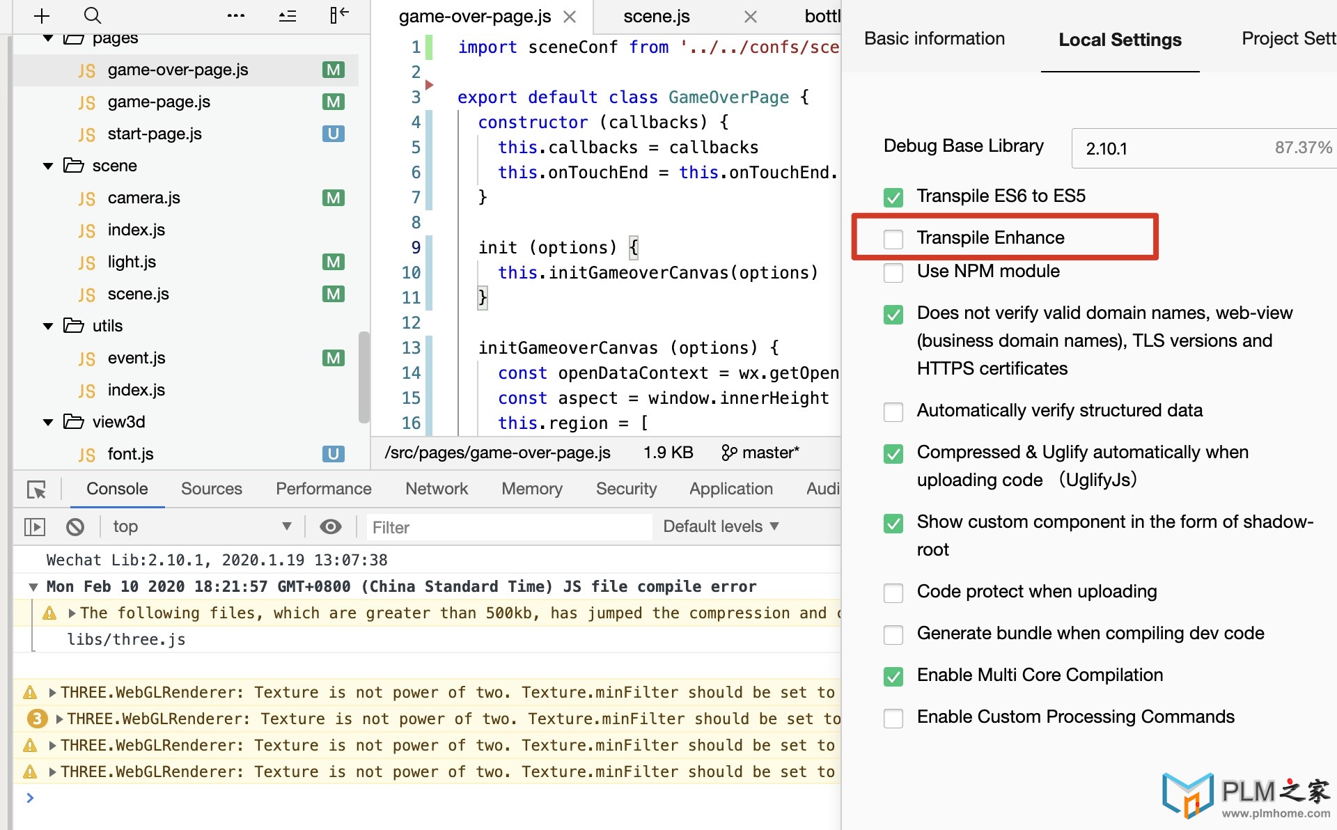

解决办法是在项目设置里面,不要勾选 增强 转换  . `# U  B5 t6 L: @. y  {7 u
3 {  ^: D& a$ H  N7 [thirdErrorReport @ VM5483 WAGame.js:2; A/ l/ |/ s# r/ o. n
(anonymous) @ VM5483 WAGame.js:2
. ^4 D; V/ g' Y. ^& zf @ VM5498 WAGameSubContext.js:2; _) F( p4 H" r& z
h @ VM5498 WAGameSubContext.js:2
. ?# n! R( Q& t: l4 C. ?% P(anonymous) @ VM5498 WAGameSubContext.js:2
6 ~2 f3 o: P+ S* P  @( ?. k4 |value @ VM5498 WAGameSubContext.js:23 d$ P% Z6 f( u* C# h, C
(anonymous) @ VM5498 WAGameSubContext.js:2/ c7 r$ q& r3 h; q. e
error (async)* F5 M& u& p: j
(anonymous) @ VM5498 WAGameSubContext.js:2" \' o. M  N$ v5 ?: x& P; T
. m4 V, U) R  ]# C(anonymous) @ VM5498 WAGameSubContext.js:2
' w, `  G( N2 S  x* ?VM5465:1 gameSubContextThirdScriptError
) P3 X2 x  B9 ~" rmodule "@babel/runtime/helpers/interopRequireDefault" is not defined
7 l# G6 a# H- x1 f* {( nError: module "@babel/runtime/helpers/interopRequireDefault" is not defined) G- K4 L; d6 w
    at require (http://127.0.0.1:55201/game/__dev__/WAGameSubContext.js:2:88260). x3 s) h+ P0 C* K& f
    at http://127.0.0.1:55201/game/__dev__/WAGameSubContext.js:2:880110 S  X- F! R4 A4 d+ j4 y' l6 g
    at http://127.0.0.1:55201/game/src/ ... -list/index.js:3:30
3 n+ t2 l& L  _' |1 ~. ^    at require (http://127.0.0.1:55201/game/__dev__/WAGameSubContext.js:2:88401)
8 y1 P* B. T* F8 C6 h    at <anonymous>:1:71
- x: c! h6 z# W    at HTMLScriptElement.scriptLoaded (http://127.0.0.1:55201/game/subcontext:16:23)2 o( z6 I: x+ E4 T% X
    at HTMLScriptElement.script.onload (http://127.0.0.1:55201/game/subcontext:26:22)7 x, T4 Y# ~! z( y1 I9 {( h8 R3 \7 T
