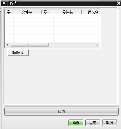

我想在UG对话框里嵌入一个MFC对话框,一直未最终成功,对话框是嵌入了,但不能对其进行操作,代码如下.' m7 E# i' Q3 ?
# @& W. @& y. W! E! \1 k6 {  Qvoid List::CreateListDialog()
( O7 [# t: D; C7 G' d{
' t# A7 G8 t3 y0 H; U, g" w- L0 s4 [
- V2 j9 o3 @) W3 W: M8 a+ r    AFX_MANAGE_STATE(AfxGetStaticModuleState());
1 ]& E# u/ y5 v7 K3 x# @1 f* w    HWND  pWnd=::GetActiveWindow();4 J8 W# y' Y" ]4 O5 D' i
    CRect rcd;
/ B& s4 G$ P9 d9 [- s9 P) y4 a9 M/ ^1 \    CString str;
! L- x7 |, G' H2 E- c   8 J+ i  d7 O" `7 J& b
    HWND hChild = GetWindow(pWnd, GW_CHILD);% x3 d5 e; p8 @
    if(hChild != NULL)+ v$ B* I. z+ i; X2 d
0 c/ y5 k. Z5 `: l. j6 w* z( y            CWnd* dialogWnd = CWnd::FromHandle(hChild);# w' b1 D2 L; ~6 G, H
            dialogWnd->GetWindowRect(rcd);
0 D. `7 d! S$ P& O6 ?  e            dialogWnd->ScreenToClient(rcd);( `5 u3 m/ {- Z) G
            BOOL re=theDlg->Create(IDD_DIALOG1,dialogWnd);
8 J& r) z$ I& |3 e- w- {            theDlg->MoveWindow(rcd.left,rcd.top ,rcd.Width(),rcd.Height());& B0 F' Y. \  d7 J
            theDlg->ShowWindow(SW_SHOW);6 l. @# T4 K& m) J, E2 ~0 b
            theDlg->SetActiveWindow();
3 S9 i% \, f/ O, ?/ i" Z# Q            EnumChild(pWnd);4 E6 q, g' l" D
     ' Q. Z3 ~+ L) Q( Y3 \7 Z: }) E
" U' M. c+ G& i9 z}
; r- s: l( a4 |& }7 p" A1 A2 y请问怎样才能激活MFC对话框?请高手指点.

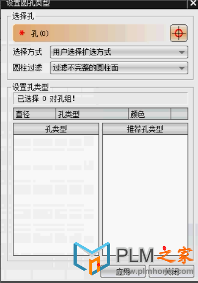

  a, I, V, n! L/ H  h
- n  {1 f7 E. l# K9 f3 k" o我见过更牛B的,所有对话框全部是用MFC做的,且界面全部是仿Block styler样式地 ggg.png ,请问版主,你认为的Block styler能做到吗?呵呵
