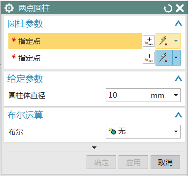

) _1 d/ \/ f' A请问怎么把NXOPEN创建的直线用UF的函数生成管道呢。我在界面上能获取任意两点生成直线(nxopen实现的),把直线转换成UF函数里边的参数后管道不能创建,请求帮助,代码如下:

                Session *theSession = Session::GetSession();
5 i0 m# J7 X9 i* h/ F6 O: M                Part *workPart(theSession->arts()->Work());# |# P; t3 A- T+ R; `2 P& @
                Part *displayPart(theSession->arts()->Display());
; o2 @; |+ W7 U. G0 v
/ x, `: \7 D* R1 ~. F8 Z0 y2 [                std::vector<TaggedObject*>pp = point0->GetSelectedObjects();    //获取选择的点
2 l8 N' R8 O; A9 ?  ], t                TaggedObject * p = pp[0];  D. V  X7 [! \! K, e5 z" e( j2 @
                Point * getpoint = dynamic_cast<oint*>(p); - y- G5 E6 y5 d- C2 |9 T
) ?9 o5 }$ Q& J/ M  c0 x# `; n1 c
; @- h) f, e: f. x0 ~8 I
                std::vector<TaggedObject*>qq = point1->GetSelectedObjects();    //获取选择的点
  M% \1 V2 E4 ^" b$ G                TaggedObject * p1 = qq[0];
% U  p3 u6 y% L: b2 s: s- Y                Point * getpoint1 = dynamic_cast<oint*>(p1);
% X. J! a7 ?( @0 Z/ m' H. T: p
/ B8 t% c% a; s, E6 v# g$ ~
/ x- A6 }+ @! s) [% n7 o& e
                Features::AssociativeLine *nullFeatures_AssociativeLine(NULL);
( x. @4 O* h% U9 b5 A* ]                Features::AssociativeLineBuilder *associativeLineBuilder1;
% T; |9 e. B$ ^1 z, ?6 a                associativeLineBuilder1 = workPart->BaseFeatures()->CreateAssociativeLineBuilder(nullFeatures_AssociativeLine);3 q. m+ e1 o5 `3 ?: D3 i: m; `
& ?0 K: U: @" W
/ z! h  `; x  Q) I9 p1 h  b
                Unit *unit1;
% X2 |4 [7 e9 C                unit1 = associativeLineBuilder1->Limits()->StartLimit()->Distance()->Units();- [0 L9 y' q+ c/ L5 {
                associativeLineBuilder1->Limits()->StartLimit()->Distance()->SetRightHandSide("0");
% U2 y( V$ b4 w" a0 m. Z% I9 F                associativeLineBuilder1->Limits()->EndLimit()->SetLimitOption(GeometricUtilities::CurveExtendData:imitOptionsAtPoint);" Z7 V) L6 m# u6 U1 r: }
  y6 _8 k) R" C  Y
2 B: J& a( H0 g$ M) h
                associativeLineBuilder1->StartPoint()->SetValue(getpoint);
9 v& H+ L: b% }: O                associativeLineBuilder1->SetStartPointOptions(Features::AssociativeLineBuilder::StartOptionPoint);' {: z7 E  B& {& G5 T& z8 `
                associativeLineBuilder1->EndPoint()->SetValue(getpoint1);
" f$ @7 R. M" a7 Q$ B% m" q, J* o! O                associativeLineBuilder1->SetEndPointOptions(Features::AssociativeLineBuilder::EndOptionPoint);. k  e5 T3 D' R
                NXObject *nXObject1;) O2 f4 @- J: `) |$ ^/ V' x
                nXObject1 = associativeLineBuilder1->Commit();: g, [$ }$ s5 M
                associativeLineBuilder1->Destroy();
