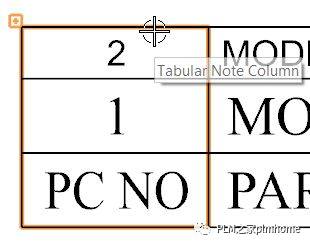

Highlight an entire column as seen below
- E" H4 W' D9 q& d1 h' V
5 k! A# Y- y7 i* D5 {
登录/注册后可看大图
& i! B7 y3 s0 @$ D- J! p& v( n
! ]2 O' P1 i1 w0 ]6 s2 P7 L5 k  g/ z0 v6 w3 I
And RMB, Settings

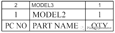

Do the modifications you want, here I want Times New Roman, with a character height of 5
* n) f% w  J; w! x7 @1 V
: ~4 L' K% p  b8 f, {! P
5 w' y2 ~" i' L6 y
/ _' j, s/ a* q
Repeat the same steps for each column to get the following:

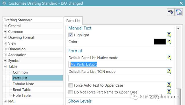

It will be stored by default in %UGII_BASE_DIR%/UGII/Table_Files
E.g. « D:\SIEMENS\NX 11.0\UGII\table_files\My_Parts_List_metric.prt »
(_metric is added automatically)
' E$ x) U* G; Z3 H( D) y
Enter this name in the customer defaults for Parts List

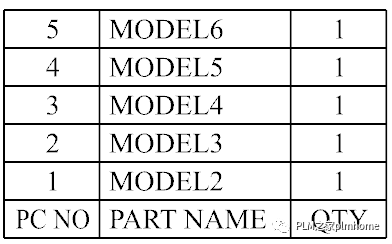

Now your newly added components will keep your lettering information
