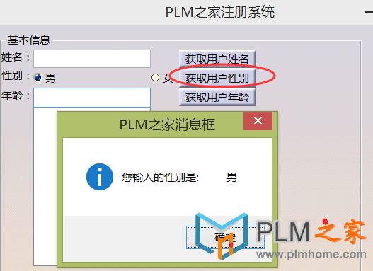

CATIA二次开发入门教程23-PLM之家注册系统学习开发之RadioBox
" T7 v+ P* ~5 D  N
+ G$ b/ o& y: E3 B( s6 m主要用到的方法就是 getState(), 通过判断得到相关性别信息!7 P7 K8 p4 r: \
6 q9 H# ?/ |' v8 Q/ w* R! {+ K
  c: A+ w5 e. T. ~+ v: t: }  g5 |" c" d% g. Q
[mw_shl_code=c,true]void PLMHomeRegeditFunctionCmdDlg::OnPushButtonGetSexPushBActivateNotification(CATCommand* cmd, CATNotification* evt, CATCommandClientData data)& N1 a  A6 n7 Y  e* j8 V  K
{' j+ a9 J) n0 `9 ~' j
+ P# Z; C9 A& g& C) h        if (        _RadioButtonMale->GetState() == CATDlgCheck), e2 D0 [/ @% l3 V0 f% q' [
        {. Z8 Z9 |/ H. G' n% w* \
                PrintMessage("您输入的性别是: \t 男");8 G" e2 `. G- r- ^( E, M
        }+ N% ?) e$ U! g( a4 w" t
        else if (_RadioButtonFemale->GetState() == CATDlgCheck)
4 P* n- a1 Z5 ]) \) P        {
  B+ S: Q; U1 u7 G- g6 H                PrintMessage("您输入的性别是: \t 女");
9 G+ O7 I7 ?2 _        }
$ B0 q9 \" {9 K0 |# r        else3 v3 w7 d3 M$ U' F/ o% J: K$ t
% i( Q. s( c7 s2 r& |, g/ b                PrintMessage("请选择性别");( V6 p% r# H4 A/ v7 p" }& ^
        }/ f  ~& r" i; ^4 m# a. C
( j2 u0 x8 L! F4 {1 K- \5 c5 T}[/mw_shl_code]2 P( d: l# a4 z7 v: ~& v. e
